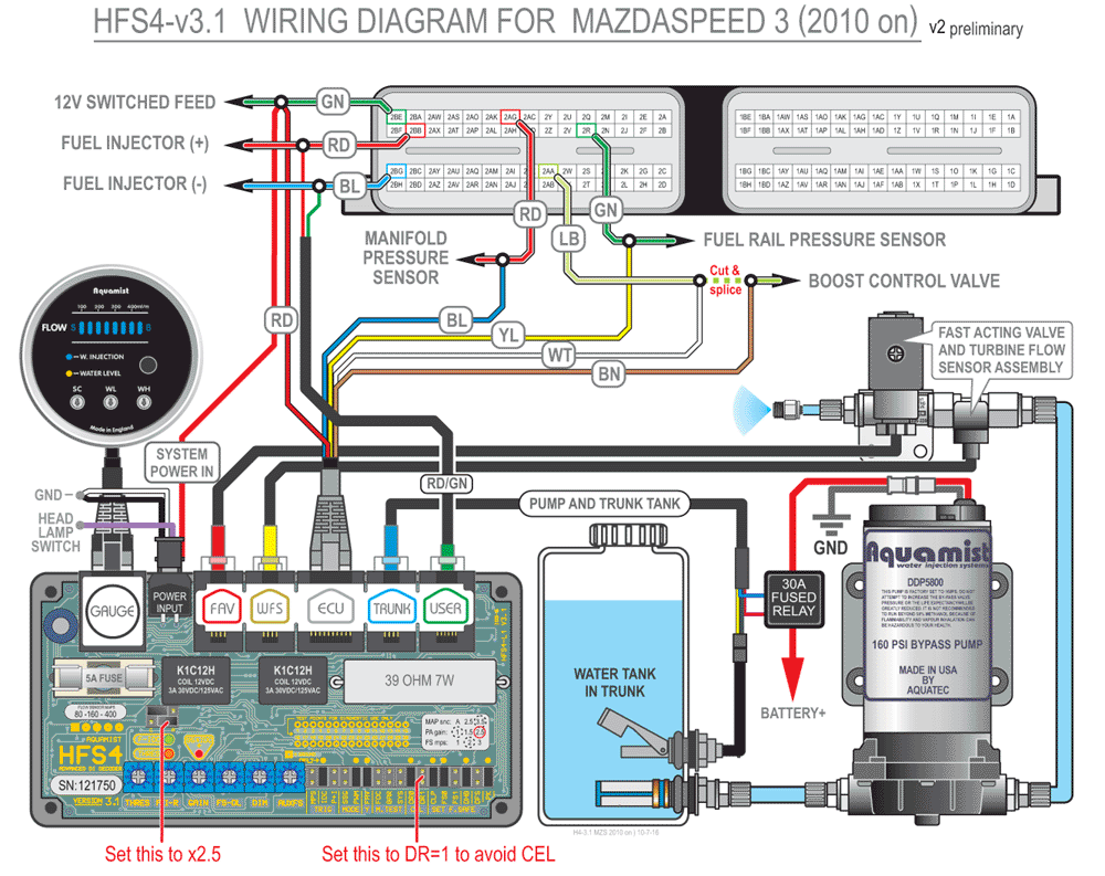

I think I found the answer to my own question. Looks like page 20 (in the manual) shows the correct wire layout for DI applications which uses the yellow cable.
I did have a few questions on the jumper and solder settings though.
For the jumper settings, I believe all of the settings should be set to the default setting except the SET FAIL SAFE. I will be using an external trigger with a 5-12V input, so I believe this jumper should be set to FS1. Both CLP and FS0 jumpers can be removed. I will use the orange wire on the RJ48 connector and splice it with the external trigger of the boost control device.
For the solder settings, I plan to use the following settings:
AUX INPUT: default
IDC PRE-SCALER: x2.5 for DI
MAP SENSOR TYPE: 2.5 bar MAP sensor so I believe I need to solder link 2
FLOW SENSOR MAP: I'm using a single 0.9mm jet so I need to solder pads 1 & 2
AUX INPUT SELECT: default
AUX INPUT FAILSAFE: I believe this should be W?
Are these settings correct?
All the settings are perfect. Not sure about the last question.

Another question for you. In the wiring diagram you have for the 2008 Mazdaspeed 3, you have pin 1AY listed as the Fuel Injector Relay. It looks like pin 1AY is listed as "+12V from ignition switch, PJB F69, 20A" in the factory connector pinout diagram I have.
Also, for #1 Fuel Injector Coil + you have pin 2BG listed which according to the factory connector pinout diagram is "Fuel Injector #1 & #4 Common".
Finally you have #1 Fuel Injector Coil - listed as pin 2BB which is "Fuel Injector #1" according to the factory connector diagram pinout.
Can you verify the diagram you have on page 1 is correct?

Is there a problem with the following: ???
AFAIK, it is correct
1AY as a switched 12V source? (2BE will also work)
Injector common is 2BG
Injector common is 2BA
