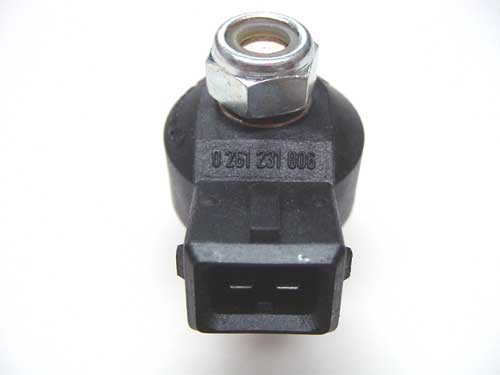

Posts: 20
Originally Posted by JohnA
This Delphi 'flat repsonse' sensor looks like the Bosch one that comes with KnockLink
Mine came with part nr.# 0 261 231 006
Gert

I decided to opt for a J&S Safeguard, configured coincidentally, for the exact same Bosch sensor. J&S allows one to choose the type of knock sensor they prefer, resonant or flat response.
http://www.jandssafeguard.com/images...0261231006.jpg
I considered a KnckBlock but wasn't able to obtain much technical information on the unit from KnockLink's US reseller. Do you have any experience with it? Does it retard ignition sequentially?
espritGT3
