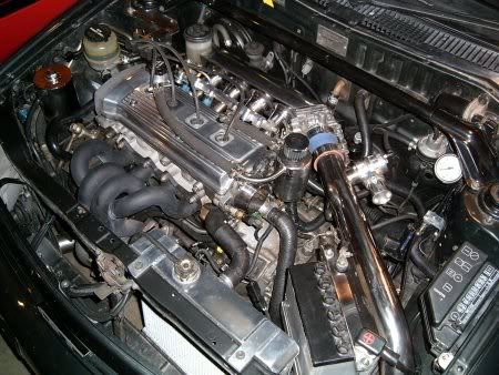

hey, heres what ive got: 1500cc 16v 4cyl engine with gt25 turbo. has a simple single stage wi setup.
at the moment its running just under 16psi with around 9 degrees advance on top a 10 degree base at that point. but has pretty much come to the limits of the fuel(95ron). as rasing the boost or timing gives light detonation. (listening through a detset) have yet to try retarting the timing some more and up the boost
was running about 180cc/m of straight distilled water. have uped the water to around 300cc/m but had little if any effect on the det. has 1800cc of injectors hitting a max of 75% at this stage. afr sits between 11.8:1 to 12:1 under full boost
is there anything im missing? or time to buy some race gas any ideas would be great.
injection point is just past the bend by the battery.

Another issue you might want to investigate is water mist distribution.
Do you know which cylinders are most prone to det? If it's always the same one, then perhaps all the water goes to the other ones.
Remember that water is much heavier than air, so it doesn't follow tight bends very well (more inertia).
So without a direct port injection your cyl1 might be getting totally different water quantities than cyl4 :wink:

good point. im guessing i'll know if the wi doesnt help the knock at all. then i'll consider going to a direct port setup. intake temp isnt really a problem anyway.

w.i seemed to help a little. but not much. maybe my jet is in the wrong position, its about 400-500mm from the throttle body on the bottom of the intercooler pipe. going closer help? or distribution problem as john says.. inlet runners sit flat as you can see in the pic. is it possible some of the water is falling out suspence in the plenum?
