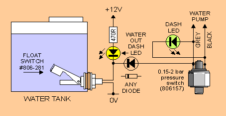

Any tips on where to wire up an LED that I can install in the dash, so that I can monitor actually *when* the pump is activating?

Here is a connection diagram, ignor the float switch part.
