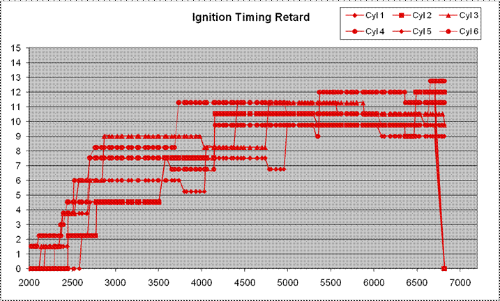

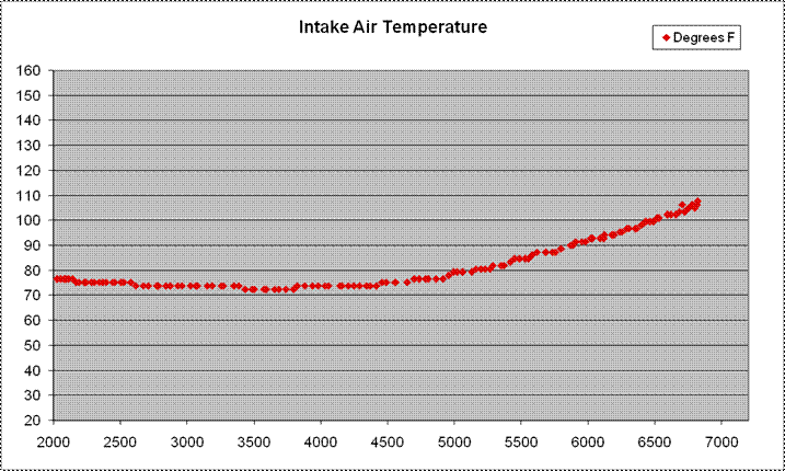

I?m in a state that has 91 oct as its max at the pump and I want to use W/I to combat the IAT and heat soak.
Some background info:
Audi S4 w/
K04/RS6 turbo @18-19psi
42lbs inj @ 4.9bar
Stock IC
Max power 600chp

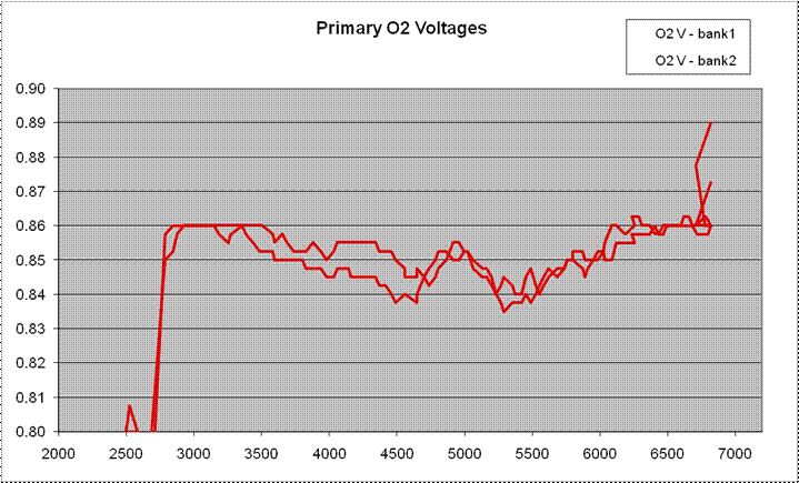

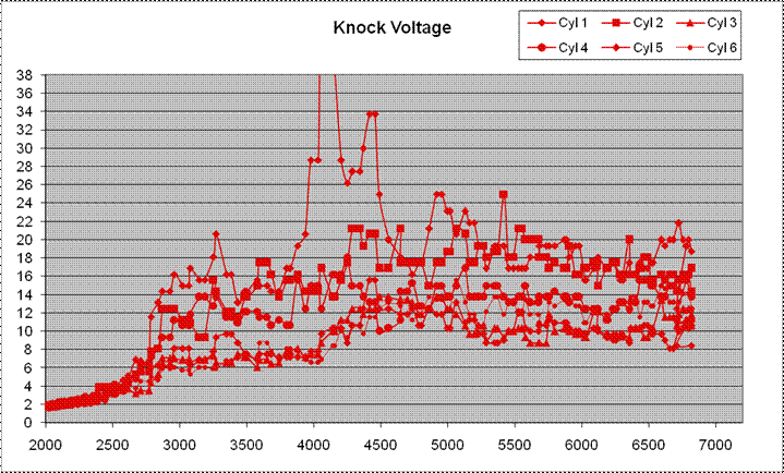

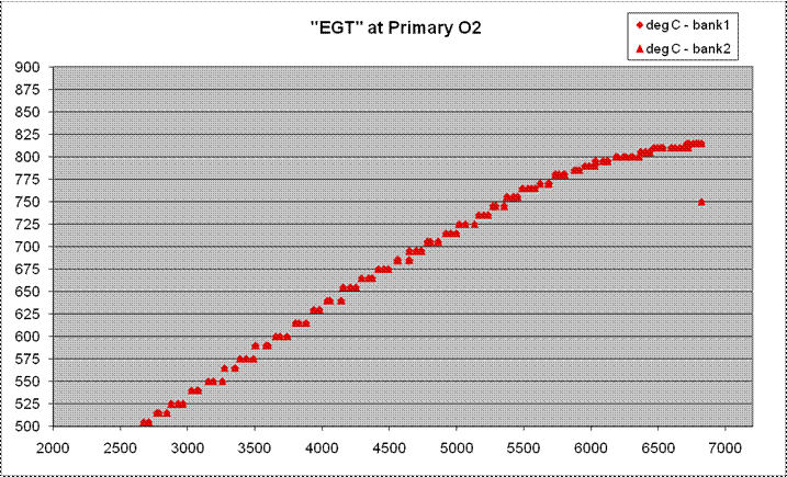

Some logs w/ stock IC @ 18-19 psi
I want to use Water only and lower just the IAT, my goal is not to retard the fame front.
My plan is to us the W/I as a safety zone, I am planning on running an AFR of about 11.3-11.5:1 w/o W/I.
