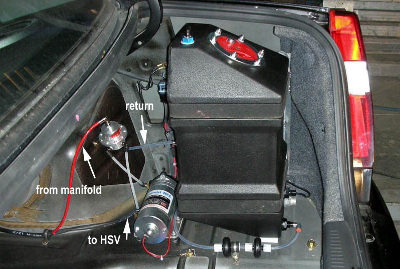

Hello Pit,
We have a user have this arragement, a proper-return to tank set up...
he also runs port injection.

did he really run a boost reference line to his trunk?

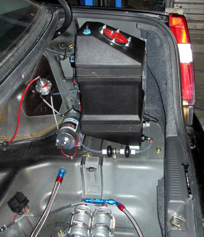

More picture info for you:
They say, no pain no gain... :twisted: yes another long hose from the enigne bay, that what he did. Before you decide on this, I need to send you a non-by-pass fitting for the HFS pump.

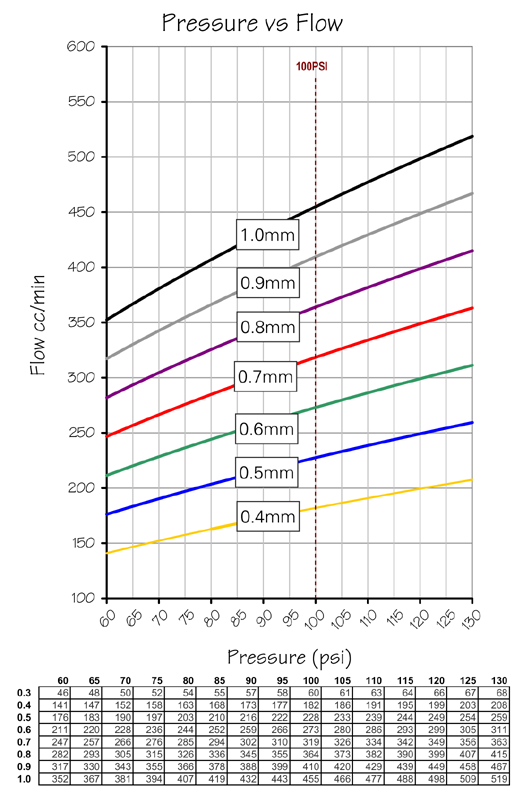

The Shurflo pump we supply can run up to 150psi as standard. When you order your RRFPR, make sure the spring is rated to woprk in 100-150psi range. (125psi normal)
Here is a flow curve of the jets:
