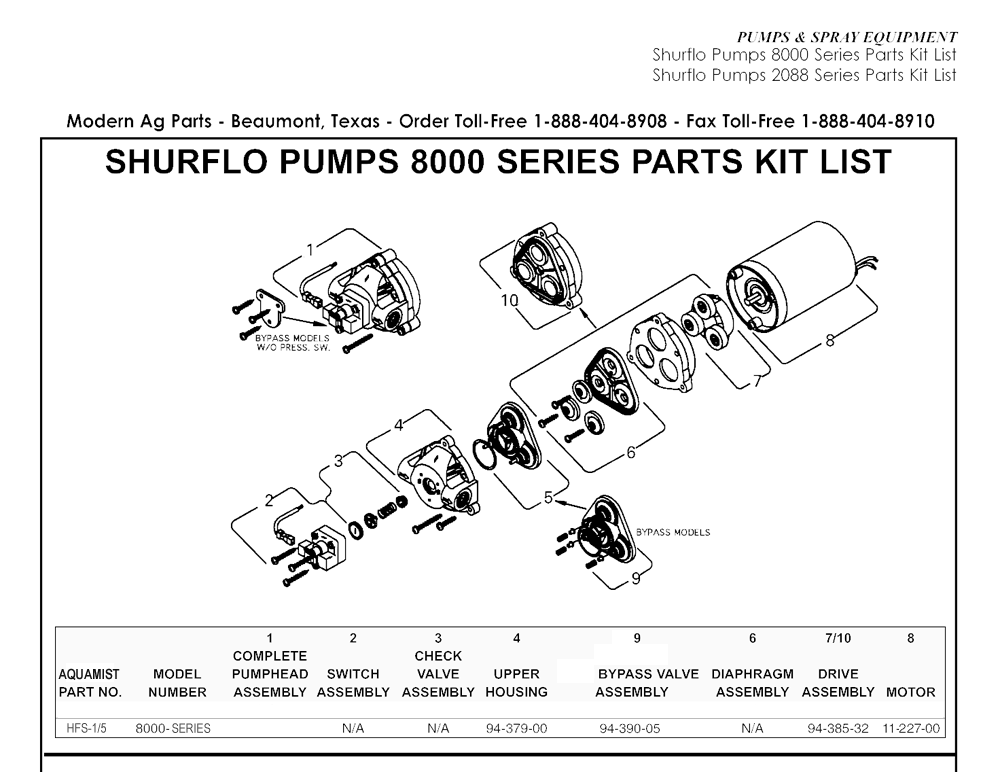

The Shurflo pump is methanol resistant (the "R" word), Unfortunately, prolong use of methanol will make the internal seal shrink, in time It will leak. For 100% mehtnaol, it last about a year. For 50:50, it is about 2 years. We have all the spares are available, it it not too costly, around $20-30 per item. normally you need to replace the #10 component (?30).
