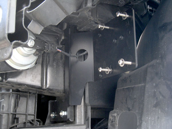

It will be upto Jeff Howerton to initiate the GB as he designed and manufacture those wonderfully designed bracket. Give him a call.

Here is a few pictures of the bracket. As Richard said, we are working on some great things with the controller to make for some interesting integration options with flash tunes.
