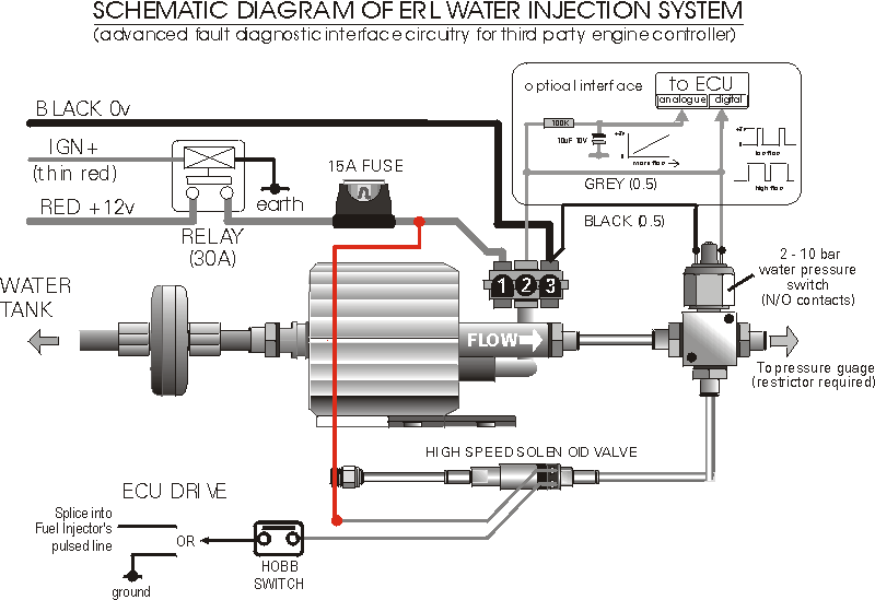

John Noonan here, I have an Aquamist water injection kit for my Turbo Suzuki Hayabusa Suzuki Streetbike. The problem I have is I am now running a Water injection kit rather than an innercooler and I am having a problem with the wiring info..( nothing came with the kit I have)
I have a hobbs switch for the kit, I am trying to figure out how to wire the Hobbs switch to the in-line valve and to power? ?
