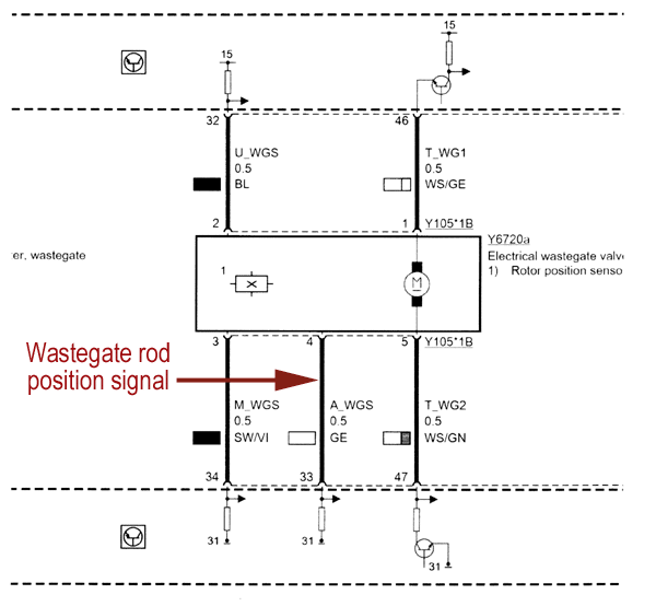

If you are willing, I am very happy to have a go making this happen. But it will require some work on your part, measuring voltage from the electronic wastegate control valve. I believe there are five wires (pin number as below):
1. Motor (+) ...... [3B/46] DME connector/pin #.
2. Power supply(+) ......[3B/32]
3. Power supply ground ........ [3B/34]
4. Wastegate rod position ........[3B/33]
5. Motor (-) ............[3B/47]
I think the DME controls the direction of the motor on pin 1 and 5. Receive in real time the wastegate rob position on pin 4.
But manipulating the voltage at pin 4, you can drop the boost without using PID control loop. We are not trying to control boost here.
The first step is to measure the voltage on all the pins at idle of just ignition on. With those information, I can start my work.

Here you go. This is with the engine off but ignition switched on. Did you want the voltages with the engine running as well?
F22 M235i
1. Motor (+) ...... [3B/46] - white - 1.41vdc
2. Power supply(+) ......[3B/32] - light blue - 4.98vdc
3. Power supply ground ........ [3B/34] - black
4. Wastegate rod position ........[3B/33] - yellow - 0vdc
5. Motor (-) ............[3B/47] - white w/ blue stripe - 1.41vdc
I verified the wire colors at the dme and also verified this is the same numerical order on the connector that plugs into the waste gate.

It is good to know there is some variations on the wire colours but DME pin # is totally accurate. If you can read the same signals whilst the engine is idling, it will be great. I believe if we manipulate the voltage on pin #4, we can control or disable boost.
I managed to find this OE wiring diagram, project ontop a solid start.

Engine running:
1. Motor (+) - 0vdc
2. Power supply(+) - 4.98vdc
4. Wastegate rod position - 0vdc
5. Motor (-) - 13.82vdc
Richard I was thinking to measure a voltage on the wastegate rod position the connector probably has to be plugged in correct? Do you need me to figure a way to do that?
Old 28-06-2015, 06:42 PM
Default Re: BMW N55 electronic wastegate
In order to read the sensor with the plug connected, you need one of these:
http://www.posi-products.com/posiplug.html
Or strip the vinyl off.
I can send you a few if you pm me your address.
The information on the second voltage test is very useful. It showed the DME was reversing the motor to see if the pin 4 changes state, appeared to be a servo setup, looking for a feedback signal.
