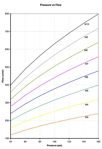

Richard, can you post some specifics for HSV valve.
I wonder how I can drive it. I believe it has 250Hz max operating frequency.
I need to know what signal needed to drive (like square pulse) and what is recommended signal duration to operate it at 1% duty and 99% duty.
What is it? internal resistance, so I can work out power consumption. Also what is it?s inrush current (if know)?
Car specifics as mentioned before:
1.8L Turbocharged motor / 4 cylinder
Four inlet ports/ 3 intake valves per port.
Considering using one HSV to operate two M3 nozzles (mounted in common section of plenum)
