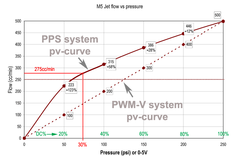

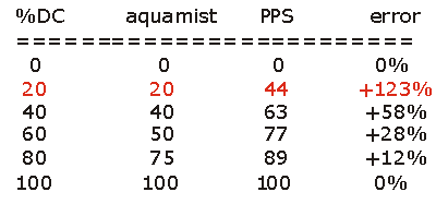

I think you are confused with our "PWM valve" system to a "progressive Pump speed" system (PPS) offered by all the other manufacturers.
The inline valve system does not exhibit those non-linear delivery curve (bottom heavy) offered by the PPS system, I will try to illustrate:
As you can see, feed the same duty cycle (%DC) yielded a complete different flow curve between the systems. Your concern regarding low RPM flow is fully justified. Until you have actually used an aquamist system, you will appreciate the difference.
Your second concern on delivery latency is common to the PPS system. The delay of reaching the flow target will depend on the hose length. For a trunk mount set up, in can be up to seconds rather milliseconds compared to the PWM-valve, constant pressure setup.
Here is a chart to make it clearer.
