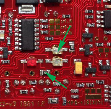

Until the system failsafe is set up, it will keep dropping the boost. We are no where near this stage. Need to sort out the green led and reading the IDC.
It appeared the green led failed. Lets move no, as it is not to important.

Can you check the soldering of the two components, it is to do with the green led.
