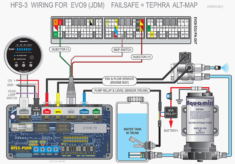

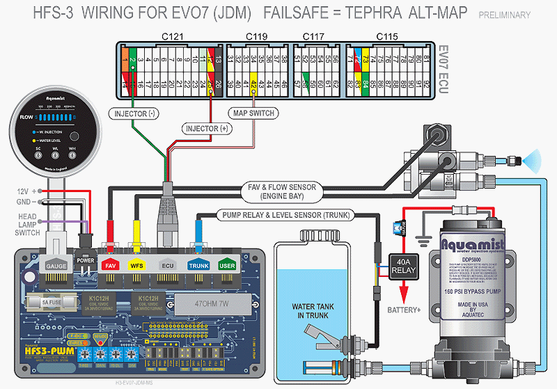

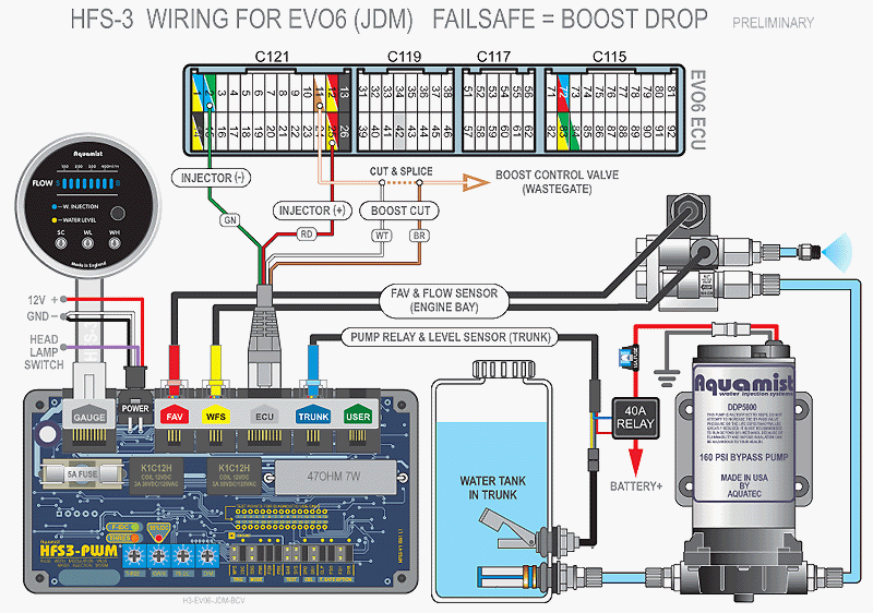

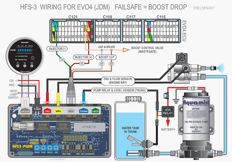

I will be working towards compiling wiring diagrams for as many makes of cars as possible for the HFS-3. I, of course need help from all your guys who owns the car to supply me as much information as possible, with feedback.
I would be grateful if you guys can post some installation images and share the experiences with others.

nice pics there richard... will be good help

great schematic Richard definatley cleared things up for me.
did the basic wiring today, il get started on the ecu tapping by next weekend.

ok thanks Richard the diagrams work 100% for a JDM 8MR, thanks.

For the JDM EVO8 MR i am supposed to tap wire 64 for Tephra map switching failsafe, however I am not seeing any wire there...am I supposed to place my own wire there?
Old 09-08-2010, 08:45 AM
Default Re: Mitsubishi EVO (JDM) wiring diagrams for HFS-3 (all non-US models)
Yes, the slot is empty. I am not sure where you can get the pins form . there is someome on the evom.net selling a pre-wired cable.

Hi Richard, can you post up a diagram for EVO X (EDM/ADM/JDM) with failsafe using Tephra Alt-Map switch via ECU pin 115?
