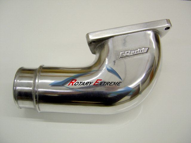

Now all thats left is the TAP .. I have a greddy elbow
now my thoughts are I bought a used model , and it has a very very little bit of thread on the injector where does that thread onto? am I uspposed to drill and tap the elbow then screw it onto that? or am I supposed to usea NUT and screw the nut onto the thread of the injector?
and if I'm supposed to drill and tap is what sized bit and tap do I use ?

You ned to rewire the green wire to the secondary injector (light green) on a n fdrx7. You do not want to tap the greddy elbow as it will strip because the aluminum is too thin to support threads. Buy one of these http://www.howertonengineering.net/p...Weld-Bung.html and have it welded to it for long term use. If you buy the bung also purchase the plug http://www.howertonengineering.net/p...king-Plug.html I just did this complete system on my fdrx7. G
