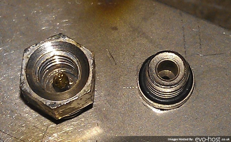

As best I can tell. The OD of the thread measures 6.3mm, so basically 1/4"
Thread pitch, on imperial the thread gauge closest match is 25G, whatever that means.
Metric pitch it's exactly 1.0mm
Inside the jet. This jet must be about 18 years old ! lol, I assume they are still the same though. This one had a 4mm hosetail on the right hand piece in the photo.

Default Re: Aquamist Jet Thread Pitch and Side (Inlet Side)
The jet was 1/4" betweem 1992 to 2002. From then it changed to M6 x 0.5mm.
Those are the real museum piece.
Haha, Ive a few of them here !! I reckon I bought them back around 1994 or so.
