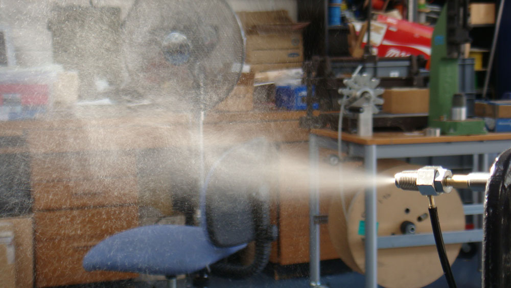

It is quite tricky to set up an air assisted nozzle. You really need minimum amount of pressure on the fluid and ample air pressure. If you have too much fluid pressure, the atomisation is not that good.
Look at the following pictures, the difference is very visible.
