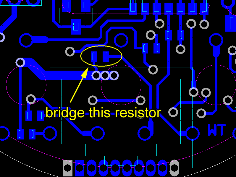

Can you solder? I like you to extend the WL range

Yes, could you guide me where and what to solder...if possible with some pictures.

The standard flow sensor reads down to ~100cc/min. Below that you need to have a "special" flow sensor, only available on request at the time of purchase. Unfortunately I was not involved at the initial pre-sale communications.
Here is the picture that will help. If you see the "B" comes on as you are CW'ing the WL, you have reached the minimum. This is on the underside of the gauge circuit board

Hello Richard, Its working now. Thank you for the great support.

Thanks for the update. You need to open up the gauge. Once done there is no "low WL" limit so make sure you do not adjust the WL too low.
